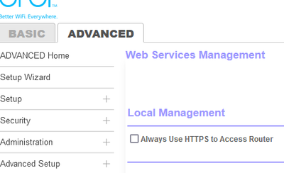

I tried unticking the HTTPS option in the Local Web Mgt settings to revert to HTTP only and both Safari and Chrome connect fine. However, they both still do not display the home page with the device status etc and fail to display some menu options.

Reverting back to HTTPS, Chrome fails with no option to bypass and proceed to browse anyway (as you get with Safari). This was the case in the past with Chrome but not anymore. I just get this with Chrome:
The web page at https://192.168.1.1/ might be temporarily down or it may have moved permanently to a new web address.
ERR_SSL_KEY_USAGE_INCOMPATIBLE
Netgear need to resolve their certificate issues or give the option to download a self-signed into your local system/browser.

- CrimpOnAug 17, 2024Guru - Experienced User
I may be mistaken, but my memory is that the choice is:
- Allow either http OR https web access, vs.
- Allow ONLY https web access.
- michaelkenwardAug 18, 2024Guru - Experienced User
That's certainly what I see.
Do that and you may break things. It seems to be intended for remote access into a router. Turning that on for local access has reduced people to gibbering wrecks until they turn up here and someone puts them out of their misery and they turn off that switch.
If you are connecting locally, then insisting on https is essentially paranoia. This is a local connection to our equipment. If you can trust friends and family โ and have a decent password for the router โ there isn't much chance that the Kremlin will break into your network. There are too many hurdles in the way.
Router users have happily managed with an http connection for years. The demand for https seems to have come from people who don't understand how network security works.
Then there is the increasing paranoia in browser builders. They try to protect people and do things like blocking http, requiring users to jump through various hoops to reach their own equipment.

- CrimpOnAug 18, 2024Guru - Experienced User
And, to make matters even less clear, this enable/disable option appears on a web page titled
YEARS ago, Orbi routers had an option to allow access to the web interface from the internet (through the WAN port).This was restricted to https and this second option was to force local access to be restricted to https as well.
When the Orbi 'app' came out, Netgear removed the ability to access the web interface from the internet, but left this option. Personally, I loved the ability to enable/disable access from the internet.
