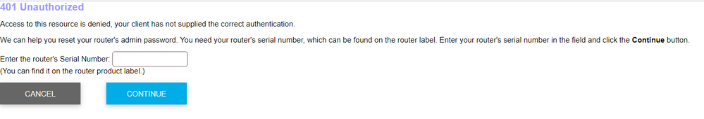

401 Unauthorized When Trying to Access Web Interface
I get the 401 unauthorized error when I try to access my router settings via the web interface. It doesn't seem to matter what device I use or whether I try orbilogin.net / routerlogin.net or the act...

ProblematicOrbi
Apr 11, 2021Aspirant
Nope. '
No luck logging in. I can factory reset, set a new password and the problem persists.
I can't even get to the actual login page. I'm immediately prompted to enter my serial number to reset the password, which I've done and it just leads me back to the same place.

- ProblematicOrbiApr 12, 2021Aspirant
I've been using Chrome on a PC and an Android device.
I'll try it with IE, Edge and Firefox and see if that helps.
Optical Network Terminal is the ISP device that turns the fibre connection into a usable network connection. I can connect my laptop directly to it and get that sweet sweet gigabit connection. Essentially a fibre modem.
Now I feel silly for not trying this earlier but I managed to login using Internet Explorer.
Any idea why Chrome wouldn't be working to login? Is there a setting I need to change somewhere?
- FURRYe38Apr 12, 2021Guru - Experienced User
Try clearing Chromes browser cache out. Nothing on Orbi to change. Would be a browser problem.
