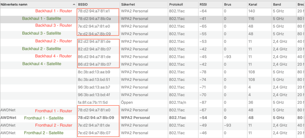

If you have Daisy Chain activated then each Satellite will start broadcasting it's own Backhaul Channel to allow other Satellites to connect to.
These Satellite's Backhaul Channels are independent of the Channels that are being used by the Router.
If Daisy Chain is disabled, then you will only see the Router's backhaul channel.
Please see the picture below showing my Roter and Satellite broadcasting at different channels with different bandwidths:
- ekhalilDec 21, 2018Master

Please tick off Daisy Chain in the Advanced Wireless settings to disable Daisy Chain.
You can check that Daisy Chain is disabled by making a wifi scan. You should only see one "hidden" network (network with no SSID) using one of the upper 5 GHz channells with the MAC address of the Router.
If Daisy Chain is enabled you will see one hidden network for every Satellite as well, with the respective MAC addresses of every satellite.
- ekhalilDec 23, 2018Master
This is what I meant:
If Daisy Chain is disabled, you will only see the Router's Backhaul in the above wifi scan. Notice the MAC address of the basestation in the wifi scan to see if it's the router or the satellite.
