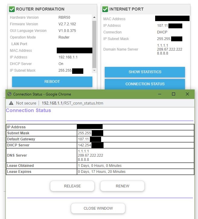

- alokeprasadJan 11, 2021Mentor
FWIW, This is what my info looks like.
My WAN IP address, DHCP server, Default gateway are all belong to my ISP.
If I recall correctly with the Nighthawk routers, the default gateway amd DHCP server for the LAN would be set to the router. Still looks that way w the Orbi.
So, everything looks normal.
Question: How do I find out my Cable modem's LAN-facing private IP address from the Orbi web interface? It is is not in the list of connected devices, but is pingable and reachable via the modem's web interface.
