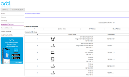

After firmware update - satellite disconnected and unable to reconnect
Hello, I have an Orbi RBK20 set with a router RBR20 and 1 satellite RBS20. I downloaded and installed the most recent firmware V2.7.4.24. The router updated fine and still works/connects. I am cu...

You may be able to download the satellite firmware, connect to the satellite at 192.168.1.250, and manually update the satellite firmware.
Might consider temporarily changing the RBR20 to router mode, attempt to reset and reconnect the satellite, then go back to AP mode.

Thank you for your input. I probably should have mentioned that when I reset the router and satellite, I disconnected everything else on the network and plugged the router directly into the modem so that I was working with it as a brand new setup. So, I have tried the router in Router mode already and it's not seeing the satellite.
The light on the satellite just has a slow pulsing white light. It's never been a SOLID white light on either router or satellite when I reset. So did I maybe do the reset incorrectly?
Since the satellite doesn't seem to have a web interface, I can't seem to reach it in order to update the firmware. I think it must have been corrupted when I tried to do the update. I thought the reset would have put it back to a working version, but so far, the router cannot detect it in wifi mode.
