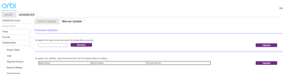

It's not resetting properly I guess. I let it blink amber for more than 30 seconds (after trying 15 or 20) and as soon as I released the button, the power light is off, never comes back on unless I press the power button off and turn it back on again. I'm letting it sit right now for a while to see if the power light will turn back on. It's been a few minutes so far. The ring light is still that slow pulsing white. I can still ping it with a command prompt again no loss of packets. Included are both pages of firmware update. Interesting that the router doesn't show up on the manual page, either.
