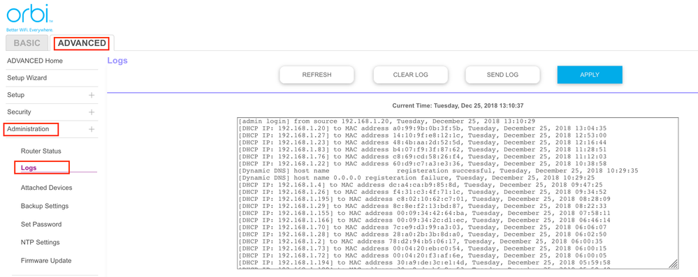

It looks that you have the router and satellite close to each other so that roaming will be triggered for some devices very often (can be an idea to get the base stations further from each other or reduce the transmission power).
My issue was caused solely by my wired speakers. You mentioned that you only had the Arlo hum connected to the Satellite. Any other wired devices connected to the router? Can you also please look in the logs and see if you have very frequent DHCP (same IP address getting DHCP assignment every couple of seconds). You can find the Logs here:
