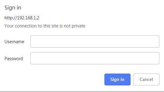

I see the satellite log in page (192.168.1.2 in my case).
I enter the user as admin and same password used for the router.
Login fails and reverts to a blank login prompt
