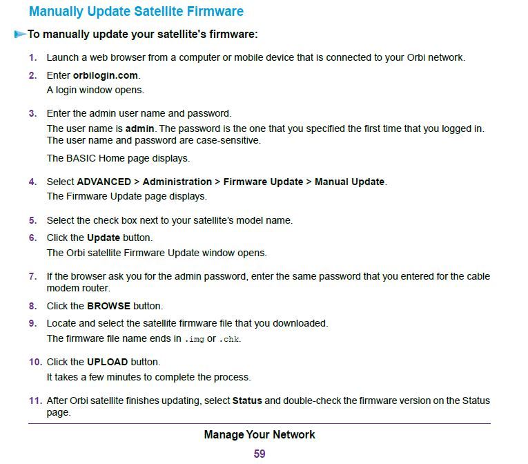

Anyway - logging in, and the Manual Firmware Update does not seem to work when connected via the RBS20 RJ45 connector. So this is defect #3...
1: missing devices in Attached Device List
2: can't manually update firmware
3; can't log in to RBS20 using CBR40 password, nor using factory default password after a factory reset.

Also talked with Indai vie support CHAT ... they argued I should not have to log in to the RBS20 since I already logged in to the CBR40 ...
So I tried a less secure browser, just in case. I got the same Orbi-mini login pop-up and same login failure. Maybe I need to regenerate the backchannel admin password ... hmm.

Since the manual hints I need to provide credentials, hard to say it's an RMA event. The last variable I can think of is I am connecting to the RBS20 via the GbE port, not wireless. Maybe some lameness in the RBS port switching that sees wired devices as remote rather than local (for security purposes); and I have PA Isolation on, which may also hamper things. Or I need to be connected to the CBR40, not the RBS20 to do the upgrade. Who knows at this point.
What is very sad in this one Netgear tech said what I was trying to do was impossible. When I got to another tech, and was going through the whole description process again, their website shout down for maintenance.

Regardless if you have reset the CBR40 and RBS20 and setup from scratch, IF the RBS is not getting the new credentials from the CBR40, then the RBS is at fault and needs to be replaced. You can try the wired connection, however the RBS needs to be fully synced wirelessly with the CBR40 first, then connect the LAN cable.
Try connecting to the CBR40 to see if it will upgrade the FW on the RBS.

Yes this has been a known issue with Orbi and upgrading dependencies. The community as a whole has been trying to inform users about upgrading the satellites first, then the main router base. I wish NG would start to put this in there FW release notes and update processes. The satellite does need to be upgraded 1st then the base last.
Not sure if this will be of any help:
https://kb.netgear.com/31573/How-do-I-manually-upgrade-firmware-on-my-Orbi-Satellite

Since my trick to log in to the RBS20 succeeded, I hadn't gone back to the web based Manual Upgrade tool. But I worried I had exhausted ways to do another FW upgrade, so to verify I should replace the system, I retried the web tool last night. I am surprised and relieved to report that I can now log into the RBS20 ... the FW upgrade fixed the issue I was having with not being able to log into the RBS20 to do upgrades.

A lot of tinkering and accidentally stumbling a cross a combination of IP addresses you wouldn't expect to find or use. The RBS20 had allocated itself to .250 ... not .1, not .2 ... took a while to discover it. And the only way I found it was to leave the CBR40 router off, if the two devices even had a second of communication the RBS20 was locked with some secret password. I tried about 20 different configurations and processes (reset this, power that, power then reset, ...); each taking an hour or so. Eventually, resetting and waiting 20 minutes, and then then powering down the RBS, then, letting it power up and begin searching for a master to sync with... at that point I connected an ethernet cable and powered on my Win7 notebook -- during that poweron Windows found the RBS20 and got an IP address from it. The PC was given the address 192.128.1.2. But the gateway wasn't .1. I think it was more chance and luck than anything else. But after I found the weird gateway IP, I tried logging in with a browser and factory credentials. It worked.
After flashing the new firmware, that same sequence no longer worked and had me concerned. And leads me to believe it was just chance it worked at all. So I am relieved I can now log in using the normal browser method.
