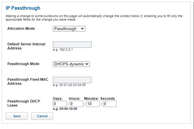

Do you have your arris properly setup in passthrough/modem only mode?
Or your orbi in access point mode?
otherwise you're in a double nat and it can cause issues.
https://kb.netgear.com/30186/What-is-Double-NAT
- pauld765Sep 08, 2021Guide
Do you know what I should have in all these fields? Or what do you recommend?
attached is a screenshot
