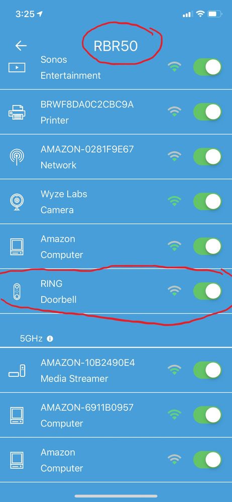

Hello my friend. I have an ORBI Tri-Band Router consisting of 1 router and 2 satellites within my network map.
The router is located in the basement and the two satellites are located on opposite ends of the first floor. My Ring Doorbell 2 is located literraly 10ft from one of my satellites. When I click on my orbi app and click on the ORBI Picture on my smart phone it shows you the Network Map picture. WHen i click on the RBR50 Router picture, it shows the ring doorbell connecting to it. NOt sure why it won't connect to one of the satellites on my first floor. Weird and frustrating.
