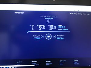

At the moment, I have CAT6 running from the ONT to the CenturyLink C1100T Modem. I get pretty awesome speeds as you can see in the picture here:

Oddly enough, I noticed that I would never even get close to the speeds in the picture above, when I used the Orbi as my main gateway. I would get probably no more than 500-650mbps up/down.
