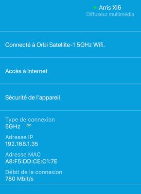

Speed is not a big big concern but I see that my Xfinity tv box is connected to my satellite at 780mbps which would not be possible with other satellites (such as the RBS20).
