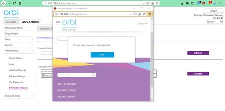

Can not install firmware upgrade
Hello community!
I have just purchased Orbi RBK50, but can not upgrade firmware on satellite (RBS50). The firmware on the satellite when checking after first power up is V1.4.0.34. I then found...

Download the following version for both RBS and RBR: v2.0.0.74.
Apply this to the RBS(s) first. Then the RBR lastly.
Then you can update the RBS(s) directly to v48. Do this first before going to the RBR.
You'll then need to apply v212 to the RBR before applying v48 lastly.
