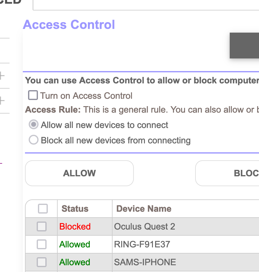

Cannot Unblock Occulus Quest
I successfully connected the Occulus Quest 2 to the Orbi RBR50. It worked well for a couple of weeks. When I used the "block internet access" function via the app it would not recconnect. I have g...

- trabbaJul 26, 2022Tutor
Sure Have...access control is turned off and still the device is blocked

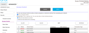

- KevinLiTJul 27, 2022NETGEAR Moderator
Hello Trabba,
Welcome to the NETGEAR Community!
I understand that you are having difficulties changing the network access permissions on your RBR50 for your Occulus Quest. Please ensure that your device is not listed in the "view list of blocked devices not currently connected to the network" section.
If your Occulus is listed remove it by selecting "REMOVE FROM THE LIST" before following the instructions below.
Please follow the instructions listed below to resolve this issue:
- Select "Refresh" (Located on the right of "EDIT")
- Check the box of the Occulus Quest
- Select "Allow"
- Then select "Apply"

- trabbaJul 28, 2022Tutor
Thanks Kevin...still doesnt work with the Access control on. Solution has been to turn off access control completely
Hi Crimp on...this is the solution. I have disabled access control. I am assuming that devices still need a password to connect and that this function only gives me the ability to throttle / block devices once they are on the network.
- CrimpOnJul 28, 2022Guru - Experienced User
I have a suspicion that if you ever (even once) use the Orbi app feature to "Pause" a device (any device), that will instantly activate Access Control again.
My appreciation for swear words increased exponentially when by accident I found Access Control ON. WTF? AlaKazam! etc. etc.
How did THAT happen????
