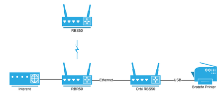

Can't Print to Wired Printer from other Orbi Satellites
I have an Brother HL-3140CW laser printer conencted to an orbi satellite via USB in my office. If I am in another part of the house, I can't print to it. To get to to work, I need to go next to the s...

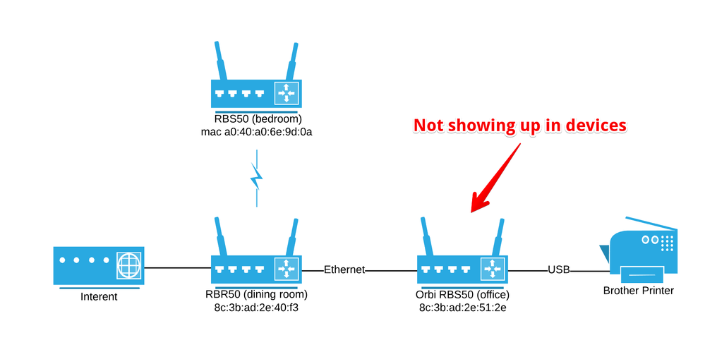

- pmauroOct 22, 2018Aspirant
When I look at attached devices, there is only 1 connected satellite shown. It is missing the one in my office that connects to the printer.
So maybe this is related to the other problem I had which I have not been able to fix. You were helping me with that as well.
