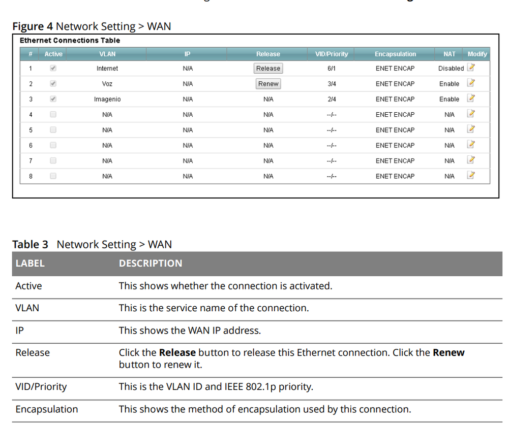

Doesn't make sense to me. Your (Pepephone) ISP does run ATM PVC on a fiber ONT? Unlikely anywhere near to normal. In the DSL world (two wire), the ATM PVC settings are configured on a modem, the router behind does "simply" PPPoE and the authentication - this is what every router or OS can handle. In a fiber/GPON environment it's typically Ethernet, very unlikely ATM. And I can't think of any decent router or SOHO/SMB security appliance supporting ATM over Ethernet.
Isn't it more that your ISP does run some specific VLAN, either with transparent TCP/IP or a PPPoE encapsulation?
Do you probably mix information available from where ever for your ISP but applicable to DSL (two wire) instead of a fiber ONT?Quickly challenged some old friends with another router maker - here the proof that they use Ethernet and VLANs, definitively no ATM. Borrowed from here:

I believe, and I am quite sure, that it's a VLAN. I do have the information about it for my ISP (ID 20 and priority 0) and I already set it up within the Orbi's configuration. If all the other things (VPI, VCI, ATM, LLC... ) are not needed for fiber connections, the case will probably be that the PPPoE user and password I have are not the correct ones.

Hard to say - challenge the ISP for the details required. Their service might reside on a different VLAN, or is differentiated just by the authentication credentials where a specific domain does point to that "virtual" ISP RADIUS server handling the authentication.
Again, the network is (almost certain - my friends selling and supporting large amounts of CPE to Telefonica) Ethernet based, no ATM and DSL in the play, so you can forget these DSL specific settings.
