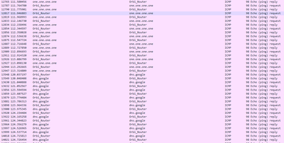

Repeated the experiment with the debug option "Enable LAN/WAN Packet Capture". That is:
- Turn off WiFi on phone.
- Use OpenVPN Connect app to VPN into the Orbi.
- Run the Fing app to ping some sites:
1.1.1.1 (CloudFlare) and 8.8.8.8 (GoogleDNS) - Observe that Ping is working correctly.
- Disconnect VPN
Opened the file wan.pcap with Wireshark. The capture file clearly shows the Orbi router sending ICMP packets to the two sites that I 'pinged' (1.1.1.1 and 8.8.8.8) and the sites responding.
So, for my Android phone, OpenVPN Connect appears to route internet traffic through the VPN tunnel, and the Orbi connects the VPN to the internet.
Am at a loss to explain why this is not working for you.
