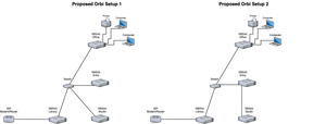

Configure ethernet backhaul with daisychain + switch?
Hello, experts! Can you help me convert my current, unreliable WiFi backhaul to Ethernet? Some constratints, off the top: ISP service is business grade, router only (bridge mode/gateway not availa...

If the business router is doing the routing, running the orbi setup in AP mode should work.

Thanks for the quick answer, plemans. I wondered about the daisychain setting, since I remember that was a "gotcha" in the wifi setup.
I have been running the RBR40 in router mode, which would mean double-NATting everything on my net. So, are you saying can I use AP mode in this config and avoid that issue?
P.S. The business router is locked down by the ISP and remotely managed from their headend, which is why gateway isn't an option. I also don't have access to routing tables to set up DMZ. :-(
