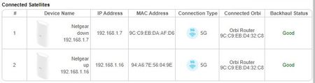

Connect directly to satellites via web interface.
I can see the satellites as connected in the web interface of the router: However, the firmware update (in Administration) page of the router does not show the two satellites even after a long...

The problem is that while the satellites show (with their own IP addresses) up in the connected devices page (even if refreshed), the manual firmware update page shows them as “waiting for connection” forever. so, your suggested method doesn’t work.
I cannot ping those satellites’ IP address and cannot connect directly to the web interface of the satellites through their IP address using the browser.
