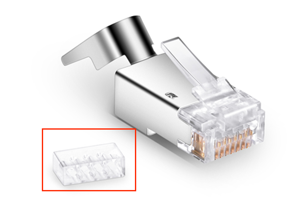

Regardng the cabling the color coding of cat7 cable is the same as cat6. But I think there are special modular plugs (shielded) for the cat 7 cables that are slightly different than cat 6.
A common mistake (that I once did) is to not use the small canal piece (see picture below) that comes with the plug without which the wires will never be in place. :)

The only other thing I'm questioning is that I had to put a new rj45 connector on the cat7. I wondered if cat7 cable accepts the same rj45 connector as a cat7. I wired it all up and used a tester to check. according to the tester everything is wired correctly and it is grounded.
