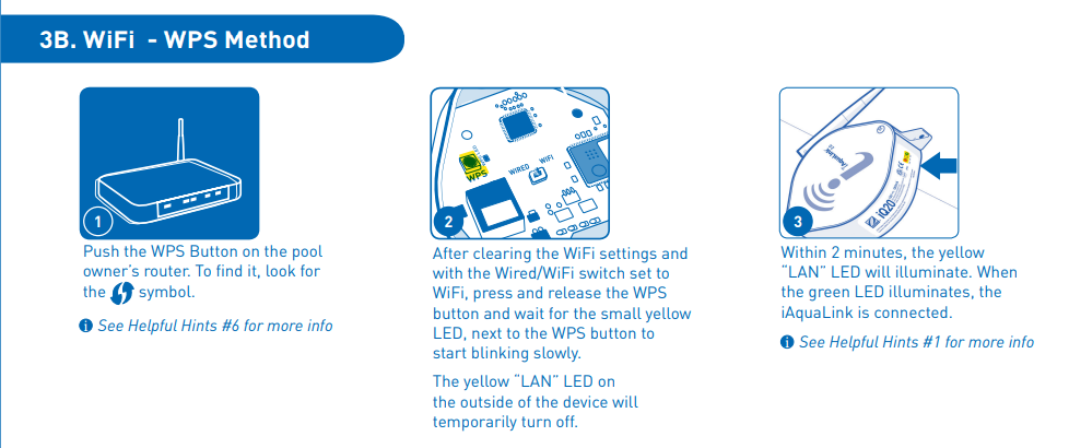

Thanks silver123 . This can be something wrong with the app cooperating with the phone OS and Orbi at the same time. The app needs to connect to the iAquaLink wifi network then pass the Orbi wifi credintials to the iAquaLink, and many things can go wrong here!
Instead, it should be much easier and straight forward to use the WPS method (since you will not need the app) as follows (from iAquaLink manual):
In Orbi you need just to push the Sync button on the back of Orbi once to start WPS procedure.
