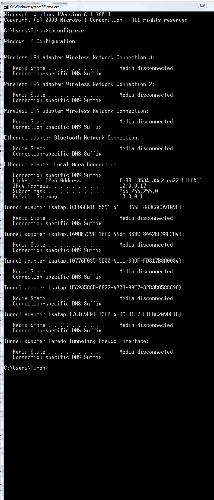

- silver123Feb 13, 2019Aspirant
at the end of his video he shows his IPconfig and it's not the same as mine, I don't know if this indicates an issue but it's not the same formatting so just going to post both, his is named Glasscock (his last name)
Please see the attachments and let me know if this is an indicator of an issue or not.
guess you can't poste 2 attachments on one post
- ekhalilFeb 13, 2019MasterI watched this video: https://youtu.be/UWey8qOOW-U
- Which one of the ipconfig’s is yours, the 10.0.0.x or 192.168.1.x?
- After the setup, instead of using the app- will you be able to reach your device by logging in to iaqualink.com?
- Seems that the iaqualink cloud needs to establishe a vpn to your device, and the issue might actually be there. - silver123Feb 13, 2019Aspirant
ekhalil mine is the 10.0.0.x and he's showing his is 192.168, why is mine 2 digit format rather then the normal 192.168

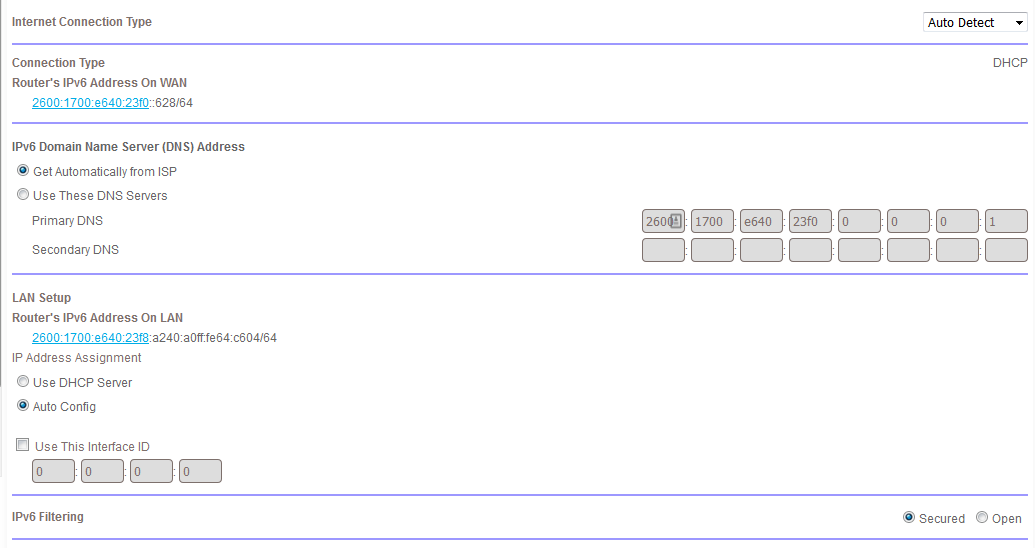

From what I could find by googling there are a bunch of threads on ipv6 for Uverse and based on the content it appears it is supported.
I have enabled ipv6 on the orbi (set to auto) not sure if it should be changed from there or left alone
Attached the screenshot
Yes I can access the orbi app from the phone and it never kicks anything offline except the aqualink.
This looks good. I think you should have it enabled if both your ISP supports it and the ISP router has it enabled.
Any change on the behavior of the connection to the iaqualink after this change? :)
Have you also checked your Orbi app access and if it really has the same behavior?
