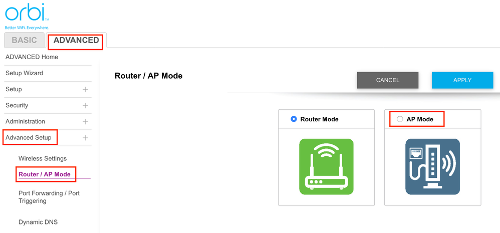

        The Arriss NVG443B is a router, so you have two ways to go:
        1. If you want your Orbi as a main router then you need to set the Arris in Bridged mode.
        2. A simpler way to go is to keep the Arris as your main router and set Orbi in AP Mode. You can do this in the GUI by going to the settings as follows:
