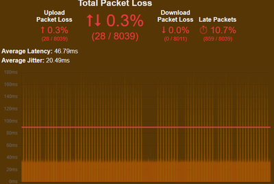

Consistant Packet loss on orbi RBR50
Starting a post since I don't know what to do anymore, Firmware: V2.7.5.4 Router model: #rbr50 router and 2 satellite OS: windows and android (I think this is what is being asked?) environment...

Would like very much to reproduce this experiment with my RBR50, but unsure what tool was used to create the graph.

After a test with changing SSID of the router and having no other ethernet cables in the router the same issue is still there. Even when disabling both satellites and checking the attached devices tab seeing only my laptop there connected with ethernet cable and no other devices listed, the problem still occurs. Hope this test gives you some insight to narrow down the issue.
my test was 10 seconds using the Dota 2 preset since that game is similar to games me and my brother play.

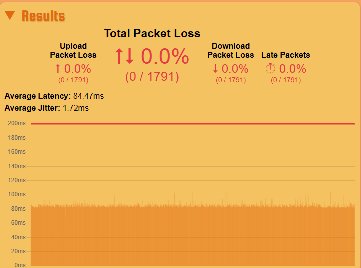

here is a test on the default preset run on 120 seconds.
It says no late packets since the threshold for that is 200ms on this test. This might explain why I only have issues with online games and not with other internet applications.

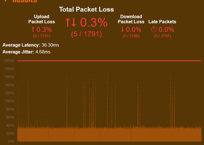

here is a 120 seconds test with the Dota 2 preset
