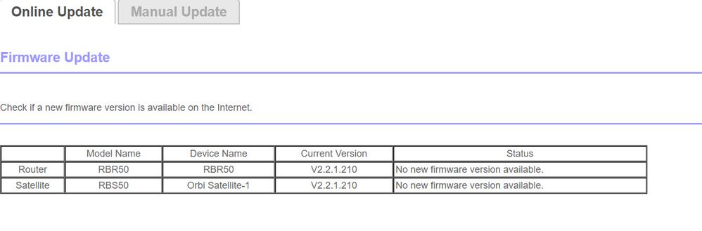

What FW is currently loaded? >> BT provided fw (MacAfee I believe?)

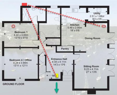

What is the size of your home? Sq Ft? >> Has a footprint of about 1200 square feet
What is the distance between the router and satellite(s)? 30 feet is recommended in between them to begin with depending upon building materials when wirelessly connected.>> one satellite installed - about 25 - 30 feet apart. There is a cavity wall in between master and satellite router. From master router to the invertor there is an external wall. The invertor is in an IP rated metal enclosure. Stood next to the metal cabinet, on my iphone I have '2 bars' on my wifi, but keep dropping in and out. I have now moved the satellite to the room on the other side of the wall to the invertor and now have good connection from the invertor (the Solaredge portal software is now updating - it wasn't previously (though I did see their device in my attached devices list)).
However, this new set-up now moves the satellite away from the outside buildings. I would have expected a better reach than what I am receiving. I would have expected the master router to reach my invertor and the satellite to be installed in the outside office and give good coverage. The way things are looking I may need a second satellite in place where I previously had the first one AND a third satellite in the home office (can I even run 3 satellites?)
