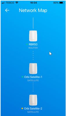

I unboxed one RBS50, updated firmware, spent the next 20 mins syncing and resyncing and finally got it set up in daisy chain configuration. I positioned sat_1 just beside my front door, about 25 feet from main router, I then placed sat_2 in my new outdoor office. And, as if by magic, it worked. Interestingly though, the app said I had a good connection on sat_1 but poor on sat_2. I connected my laptop to both sats in turn, ran speedtest, absolutely no difference in returned results.

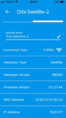

The web app showed this:

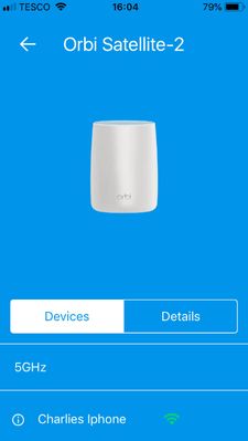

Note the 2.4Ghz connection type. Confusingly though, the mobile app was showing the only device connected, my iphone, as 5Ghz connection:
..... but also only showing a 2.4Ghz connection when I clicked on the sat_2 router:

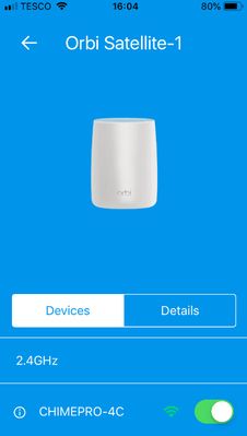

Even more confusingly, sat_1 which listed as a 5Ghz connection in the web app, only showed 2.4Ghz in the mobile app:
It's hard to know which app lies most - mobile app or web app!!!

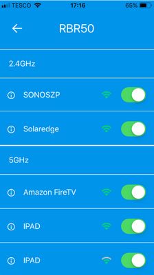

Whilst moving the sat_1 router around I realised my Solaredge inverter had made a connection to the main router:

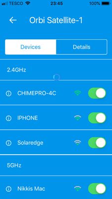

However, a few hours later, it had dropped that seeminly strong connection and hooked on to sat_1:
This is really weird. If a ddevice should connect to the strongest signal then surely it should connect to the main router. It is for situations like this that it would be really useful to have the functionality to assign devices to particular routers because the current loigic doesn't work.

It seems that sat_2 was not able to establish good backhaul to sat_1 due to weak signal. Therefore, sat_2 switches over to 2.4G.
What were speedtest results?
Were they above 2.4G bw limit?
v210 has stronger and better signal. You can give that a shot and downgrade from v44 to v210 and see if backhaul signals improve.

As the sat-2 was showing a 2.4Ghz connection in the web app, I was surprised to see my iphone showing as 5Ghz, whilst connecting through the sat-2.

- SW_Apr 06, 2019Prodigy
The 2.4GHz is the backaul connection. The client still can make 5GHz connection to Satellite regardless of the backhaul back to the main Router. Since your max download speed is 45Mbps, it's still within the range of 2.4GHz bw and you won't benefit from 5Ghz bw in this case. A "Poor" backhaul connection in this case won't have performance impact on your setup unless you upgrade to Gbits download speed. If you are able to get 45Mbps in all area of interest, then you are golden.
