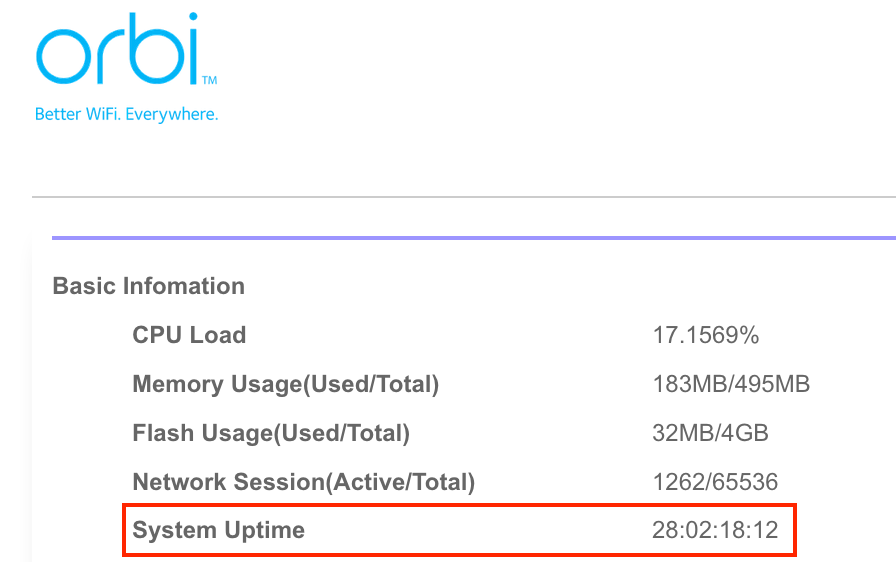

- ekhalilNov 24, 2018Master
Almost a month uptime without the need to restart my system. I'm now happy with the performance of Orbi. Great coverage, stable wifi and good usuable features.
There are still minor issues that I'm sure Netgear will tackle in the coming releases.
