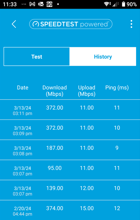

- CrimpOnApr 01, 2024Guru - Experienced UserThe same thing happens to me when I test Spectrum cable internet. The "normal" speed test is just over 350Mbps, but every once in a while the reported speed is much lower. Internet is a shared service. When there is a LOT of load, performance will be less. - ChrisCox1952Apr 01, 2024GuideThanks for reply, i understand your message. However if i talk about 2 speedtests i perform them seconds after eachother, therefore (i assume) load should be the same and is not the reason for difference in speed regards Chris - CrimpOnApr 01, 2024Guru - Experienced UserIf it's not network load, it's probably the NSA spying on your router and consuming vast resources. (April 1 Joke) The Orbi 'app' keeps a small record of Speed Test results. Here's mine: I just ran Speed test again, got 171 and then seconds later got 372. Most of the time, the results are in the 370 range. I suppose a person could swap out the router for a different one and see if the phenomenon can be replicated. If this happens constantly, then a call to the ISP might be in order.
