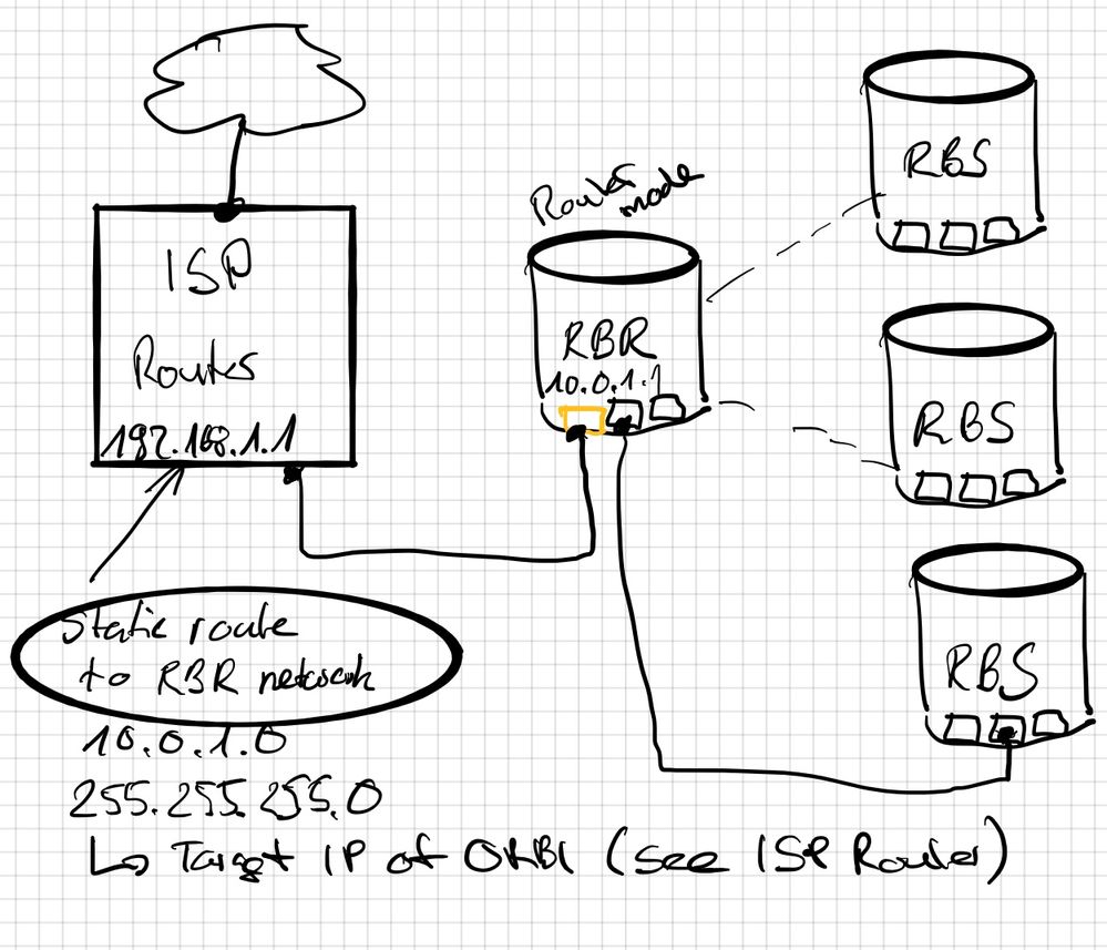

Ha_Ku_Na wrote:
sprstrx wrote:I have the router provided by my ISP which is what I'm currently using but it's pretty limited in what it can do and can't be used in Modem Only mode
I would use the ISP provided router and connect the RBR to this router.
And if the ISP provided router has WIFI, turn it off.
What type of ISP router you have ?
Could you set a "static-route" there ?A little picture to better show what I mean.
Doesn't matter if the ISP provided router has limited functionality.
Therfore you have the ORBI system where you connect all your switches, devices, ...
The IP addresses can change, adapt it accordingly
Ha_Ku_Na
Apr 09, 2021Luminary
Ha_Ku_Na
- vajimApr 09, 2021Master
Just curious.....are we saying in your drawing to put the Orbi in router mode?
- Ha_Ku_NaApr 09, 2021Luminarysure
ISP router with static-route, wifi disabled -> ORBI in router mode
That way you can use all features from the ORBI. - sprstrxApr 09, 2021Tutor
Ha_Ku_Na wrote:
Thank you for this Ha_Ku_Na I really do appreciate the help
It has reolved the issue :)
