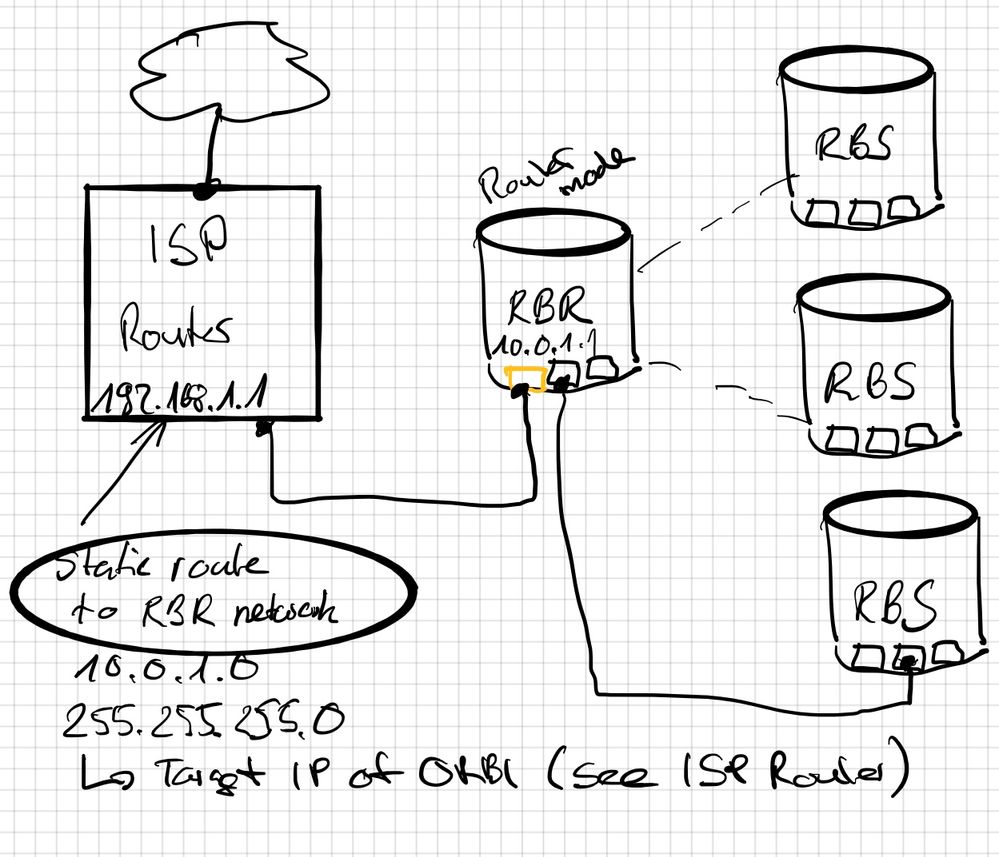

sprstrx wrote:I have the router provided by my ISP which is what I'm currently using but it's pretty limited in what it can do and can't be used in Modem Only mode
I would use the ISP provided router and connect the RBR to this router.
And if the ISP provided router has WIFI, turn it off.
What type of ISP router you have ?
Could you set a "static-route" there ?A little picture to better show what I mean.
Doesn't matter if the ISP provided router has limited functionality.
Therfore you have the ORBI system where you connect all your switches, devices, ...
The IP addresses can change, adapt it accordingly

sprstrx wrote:Thank you for this Ha_Ku_Na I really do appreciate the help
It has reolved the issue :)
