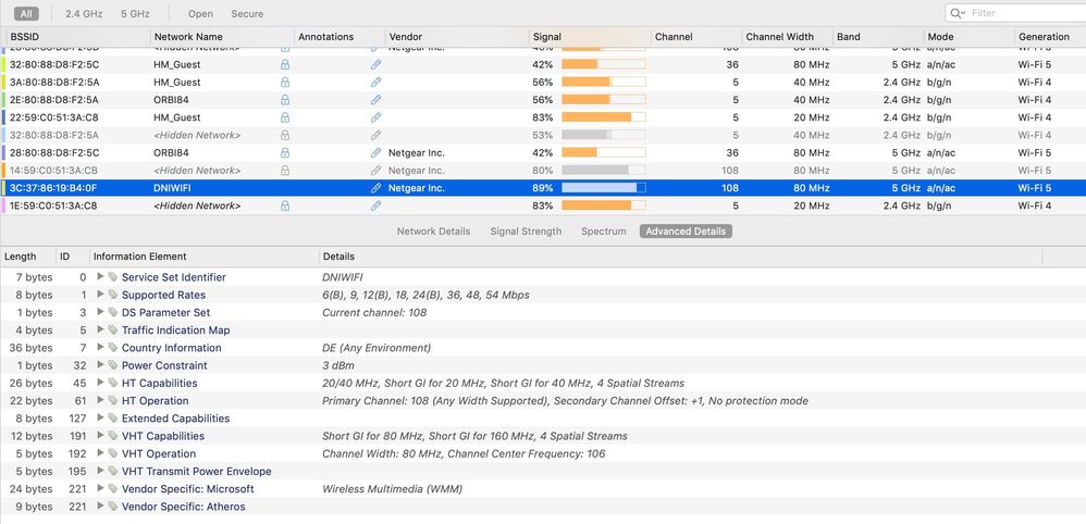

Thanks for the advice - yes the DNIWIFI SSID has the same IP address as the RBR50 router
I've turned off the printer and DNIWIFI is still transmitting without any security
- mgil1Mar 23, 2019Star
OK, the wi-fi analyzer was good - I've figured out it is the RBR50 router and its over the 5Ghz frequency at the far end of around 100
it also seems to drop in and out ...

Ignore Printer posts - that was a red herring - I have a HP and it definitely is not the source of DNIWIFI - this SSID is definitely coming from the Orbi RBR 50 router on 5 GHz and at channel 100....
- mgil1Mar 24, 2019Star
I've figured out the DNIWIFI rogue SSID is being transmitted on the same channel and frequency as the 'Hidden Network' the Orbi creates for connecting the satellites (I guess) I've attached a snapshot of the outpout from the Analyzer
