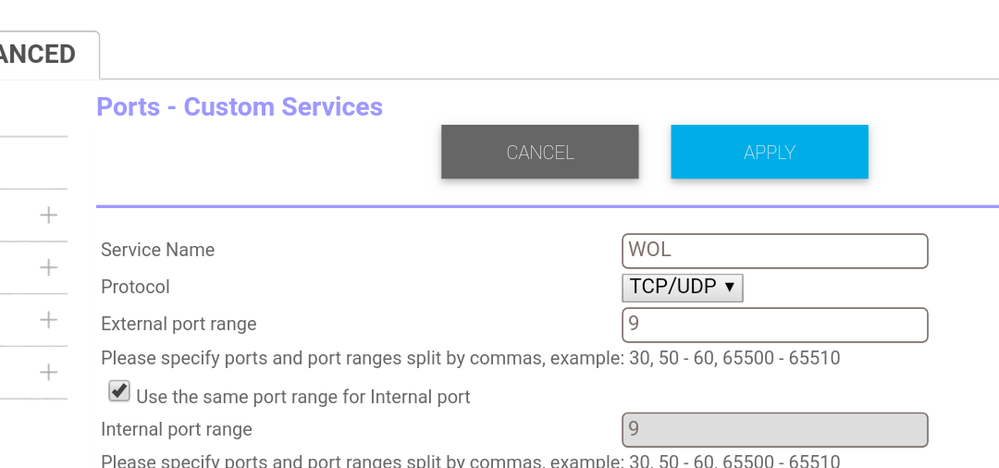

Does Orbi support ARP binding so I can wake up an attached NAS via the internet?
Hi,
I am using the Orbi RBK2200, 1 main unit as router and one satillite. I have a synology DS218+ NAS attached to the orbi router unit via lan cable. DS218+ supports WOL and I can wake it up w...

still have problem. I established vpn with orbi from my phone. but the subnet is different so I still cannot access the router for configuration of ARP. Any idea how to do it?
- ekhalilJan 25, 2019Master
arkouda wrote:
still have problem. I established vpn with orbi from my phone. but the subnet is different so I still cannot access the router for configuration of ARP. Any idea how to do it?To access telnet on Orbi follow the following steps:
- Log in to your router on orbilogin.com/debug.htm or http://192.168.1.1/debug.htm
- Enable Telnet
- Telnet from your computer using the command: telnet 192.168.1.1 (or use the IP address of your router if not default)
- Sign in to the admin account using your Orbi admin password.
- Enter the commands as described.
- arkoudaJan 26, 2019Tutorstill couldn't get it working. I can power off the nas through vpn but not power on. guess I am out of luck
