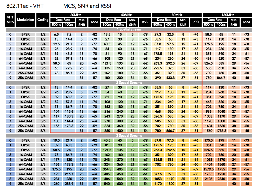

Orbi operates one fronthaul (client) network on the 2.4GHz band (with a 2x2 radio—two spatial streams up and two spatial streams down—offering speeds up to 400Mbps), one other fronthaul (client) network on the 5GHz band (with a 2x2 radio offering maximum speed of 866Mbps), and a second backhaul 5GHz network with a 4x4 radio offering maximum speed of 1733Mbps.
The maximum bandwidth of the used 5GHz channels in Orbi are 80 MHz (not 160 MHz as in routers supporting HT160).
Please see the table below. The -theoritically- possible fronthaul wireless speeds in Orbi are those that are in the red square (maximum of 2 spatial streams with maximum of 80 MHz bandwidth). The MCS value that your connection will get depens on how close or far you are from the router/satellite, the radio conditions among other things.
