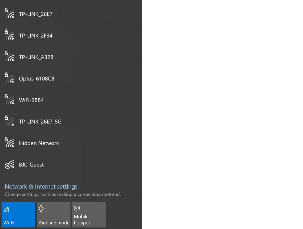

Hi,
The other day I switched over to a new Netgear Orbi Mesh system with a RBR850 router and RBS850 Satellites running firmware V4.6.3.16_2.0.51
All seems ok for all my devices except for the work issued Lenovo Thinkpad L14. All drivers, firmware etc on the laptop appear to be up to date.
I get disconnected from the network every 5 minutes or so. Laptop is about 30cm away from the satellite. It asks for the WPA2 password on each reconnect. Interestingly it displays this cross on the wifi logo that I have no seen before https://imgur.com/a/27X1BTE (SSID BJC-Guest)
Does anyone have any idea what that icon means and what could be the issue with the dropouts??
Thanks
Brad

  • CrimpOn's avatar
    CrimpOn
    The WiFi symbol with a 'x' on it is not unique to Lenovo.  Apparently it indicates there has been "a change" since the last time the laptop connected to this particular WiFi system, probably a different password.
    https://www.windowsphoneinfo.com/threads/wifi-network-has-x-next-to-it.489938/
    This article recommends 'forgetting' this WiFi network and connecting to it again.
    There is no obvious reason why a device would lose WiFi after five minutes.
    I would attempt to replicate the experience with other WiFi networks. (friend? neighbor? work?. What about a smartphone Hot Spot?)
    Would also 'forget' both the primary and guest networks, select the primary network and mark it to 'connect automatically.'

    • brad_c's avatar
      brad_c
      I think this solves the issue. For what it's worth I previously had muliple SSID's on different VLANs (Meraki setup). The BJC_Guest SSID was an old SSID that the majority of my devices connnected to. I tried to be cleaver/lazy and resuse the same SSID/password in the hopes all my wifes devices and IoT stuff would just auto connect.
      After "forgetting" and reconnecting the drop-out issues appears to have resolved itself.
      I'll keep monitoring for a bit but appears to be all godo now :-)
      Thanks for your help
