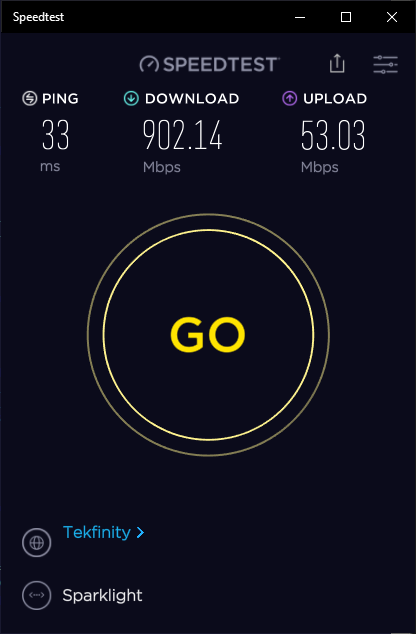

I get this with my RBR50 with v15 FW loaded:

Apr 26, 2020Why would anyone post a pic of their speed results/installed firmware?
Aren't home networks different? ISP service plans, number of devices connected,numbers of family members, etc?
