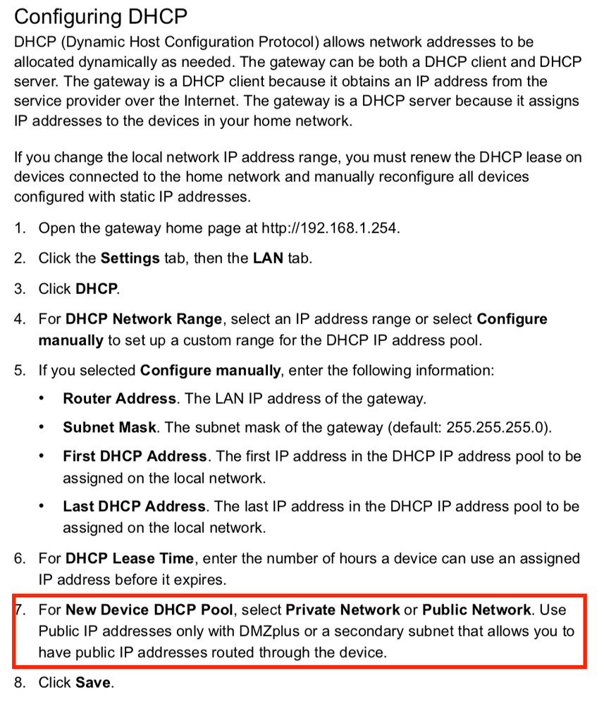

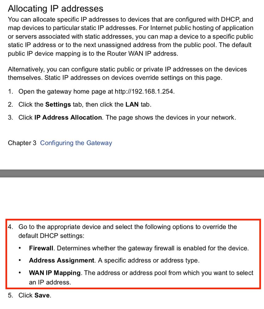

Great that removing the DMZ solved the Wifi calling issue. I went through the manual of your ISP router. Two things that might caused DMZPlus configuration not to completely work:
1. The DHCP addresses assigned to the DMZ port should be marked as public addresses. Please check if that is done.
2. There should be a reserved IP address for Orbi in the ISP router with no firewalls enabled

I placed the Orbi back into DMZ (having it outside the DMZ definetly not desired as you indicated would happen I ended up with double NAT and then some applications I tried to use would no longer work).
I followed your instructions. For the first step the router would not let me modify the field for public/private IP addresses the drop down box only offered private. However, when I validated the data from step 2 of your instructions it looks like when I placed the Orbi into the DMZ zone the router automatically assigned the Orbi the public IP address for the ISP router (mapping it) and is shows firewall disabled. I included a screenshot of this config setting from the router. Based on what I see I believe the router is configured to achieve the desired configuration you were wanting me to setup.
I did try another call again and as expected the call failed.
Thanks for all your assistance in troubleshooting this issue.
