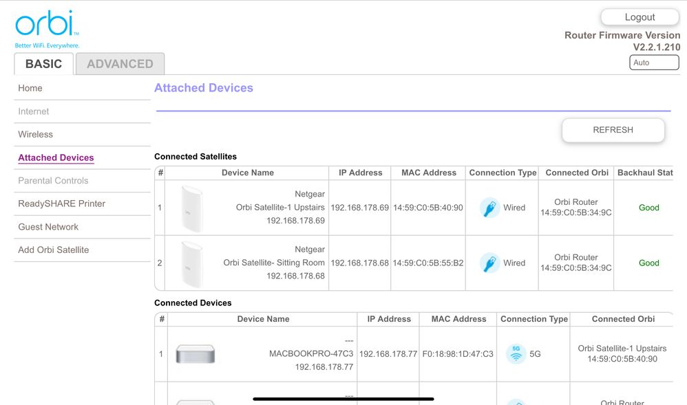

Guys looking for some advice trying the Ethernet backhaul on my set up, modem is connected to Orbi via internet connection, LAN 1 on Orbi Router is connected to 24 port gigabit switch, everything else connected to gigabit switch, yet I am still only getting between 3-400 mbps on a 1 gig connection, if I connect everything to switch I get the same speeds but am unable to connect to App or Orbi login site, daisy chain is switched off, am I doing something wrong here? I have two satellites (RBK 53 Set Up). Satellites are showing as wired with good on the backhaul page on log in. I am also set up in access point mode and everything is up to date firmware wise
- 074Feb 19, 2019AspirantIt’s set up in AP mode, tried disabling beam forming, MUMMI and daisy chain modes also, I then reset Orbi and connected in router mode with no cables and enabeled daisy chain etc and there is very little difference in speeds, wire is indicating 960 mbps from switch. router is fritz box 7560, everything seems to be connecting at the 2.4 ghz band for some reason, house is two story small house so Satelites & Router should be fine, switch is Netgear 24 port switch unmanaged (NETGEAR GS324 24-Port Gigabit Ethernet Switch), hope this helps my head is wrecked with this
