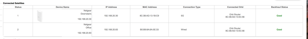

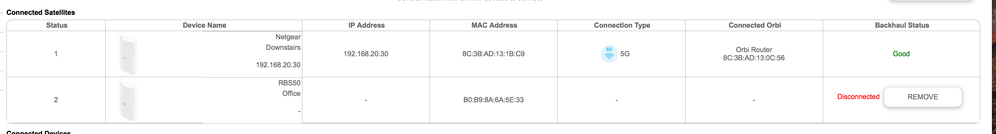

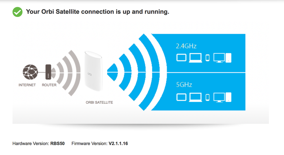

So just upgraded to 2.1.1.16, moving in the right direction. CPU usage is down and devices are starting to show up again. One issue that doesn't seem to be resolved is a wired Satelite either shows up as disconnected, or as a regular device in the device list now. Logging into the satelite I can see connected devices so I know it's working. Performed a sync on the Satelite and it didn't help.
1 Reply
  • Crossing my fingers, but this looks to be working now. I unplugged the cable and pushed the sync button. This made the satelite come back as connected and also showed the status as wired (?!?!, whatever) I then plugged the cable back in. At this point both satelites showed as disconnected, waited about 3 minutes and they are both now showing connected. Hopefully it's all good now.. and just FYI I'm in router mode.
    Weird thing now is wired satelite either shows no icon or the generic network icon.. ¯\_(ツ)_/¯
