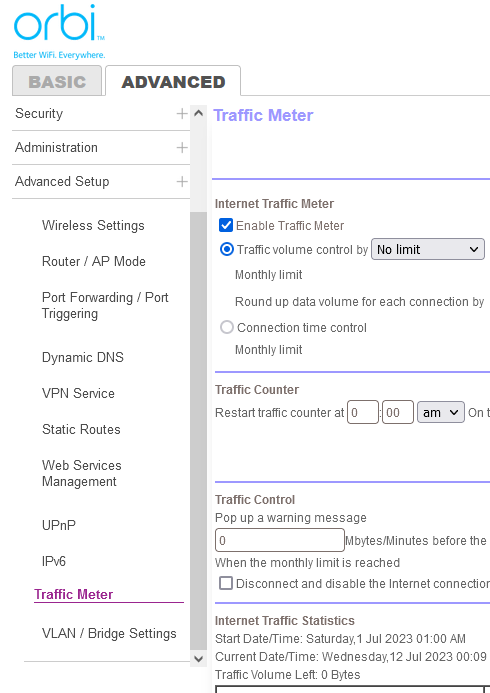

- CrimpOnJul 12, 2023Guru - Experienced User
On the Orbi web interface, Advanced Tab, Advanced Settings Menu is an entry for Traffic Meter:
Observe the top line:
If you are using 16GB/hour, removing the offending device should be obvious in less than one hour.
