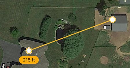

Extending wifi to metal buildings
I've searched the internet to abnauseum & have found many suggestions, but thought I'd pose my issues here. I've got the RBR50, with one satellite. The router sits 215' +/- a foot, from the close...

yes you could use a point to point system like netgear airbridge. Its a bit of an expensive option for that distance but they do make cheaper versions.
You'd need one on the house and one on the shed.
Then from there you run it it to switch/access point. You could use any of the RBS satellites with ethernet (sadly not the RBS50Y or RBW30) as an access point so it'd integrate. I've seen that done before successfully.
