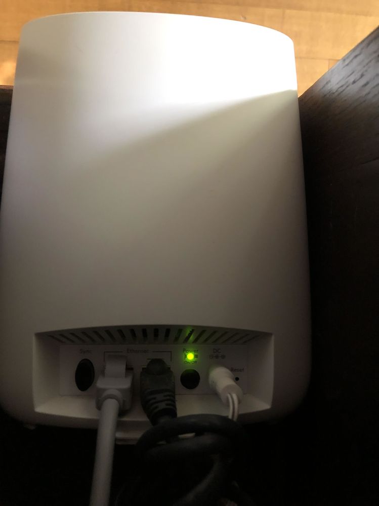

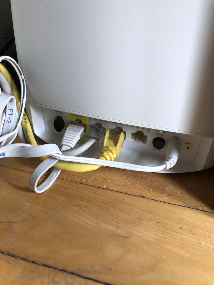

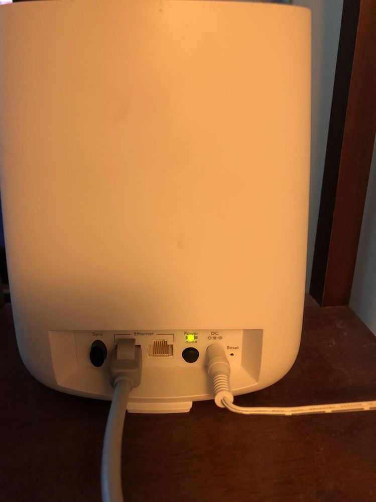

Pictures:
- RBR40 Router - It's the light gray cable that runs to the first floor satelliteRBR40
- RBS20 Satellite - First Floor - light gray cable goes back to the router. The dark gray cable is first floor satellite to basement satelliteRBS20 - First Floor
- RBS20 Satellite - Basement - please note in the basement router photo the lighting makes the dark gray cable look like the light gray cable. But it really is the dark gray cable that's plugged into itRBS20 - Basement
