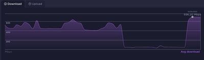

- GWildOct 23, 2022Guide
Odd you should ask; while grabbing my firmware numbers I checked speeds and found my kit has also reverted to 50Mb/s ...
wifi through base router at 525Mb/s, wifi thru satellite at 48Mb/s. Now investigating. Will report back...
The only thing I did recently was to try to reduce slave power - only option was to reduce all power, which lost ALL backhaul connectivity (router/slave 20 feet apart, go figure: I now firmly hate Netgear products). After finally wiring up to regain access to the router, reset power to 100% -- network seemed to come back after several power cycle resets.
Going to reconnect / resync the satellite. Hoping that gets the speed off 48Mb/s ... Netgear software is just crap.

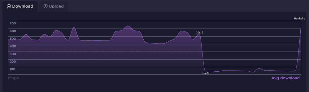

Status:
Model Device Name Firmware
Router CBR40 V2.5.0.28
Satellite RBS20 V2.7.3.22 - GWildOct 23, 2022Guide
Well - seems I can't get back to 600Mb/s or anywhere near it. My guess is Netgear pushed a patch to the Orbi system that isn't public and we all have to suffer the forced downgrade until they figure it out and push a new patch.
Seriously - how can a business do this and get away with it legally? It's like Apple intentionally reducing CPU clocks to make it appear battery life isn't declining.
As perfectly good routers continue to functionally "decline" under Netgear's control, consumers think it is their "usage" has grown and they need new gear.

- GWildOct 25, 2022Guide
All attempts to resolve the speed issue at the satellite failed. Reboots, Factory Resets, Resyncs, FW changes, etc.
Factory reset of the router has restored partial speed -- now getting about 300MB/s - nowhere near the 500+ I was getting.
Reloading settings saved earlier today yielded the same 50Mb/s backhaul.
Reloading settings save in 2021 yielded mediocre ~350Mb/s data rates.
386.14 Mbps DOWNLOAD
31.68 Mbps UPDefinitely a CBR40 issue - nothing to do with the slave.
