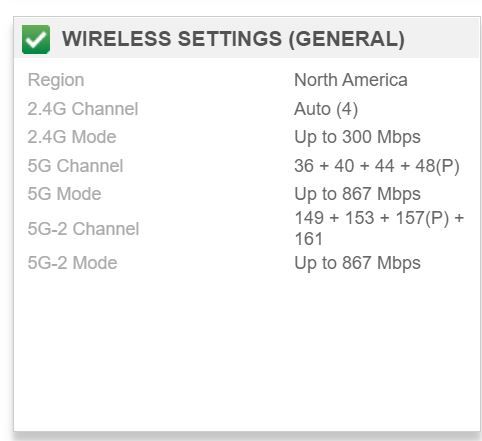

As you can see, my CBK42 is showing only one 2.4 channel, not 2 like your is, and that was after a full factory reset.
Also -- how did you get to an RBS20 screen that shows CPU loading. I have no such display on mine. You must have a newer hardware version.

Your pages are different than my pages ...
