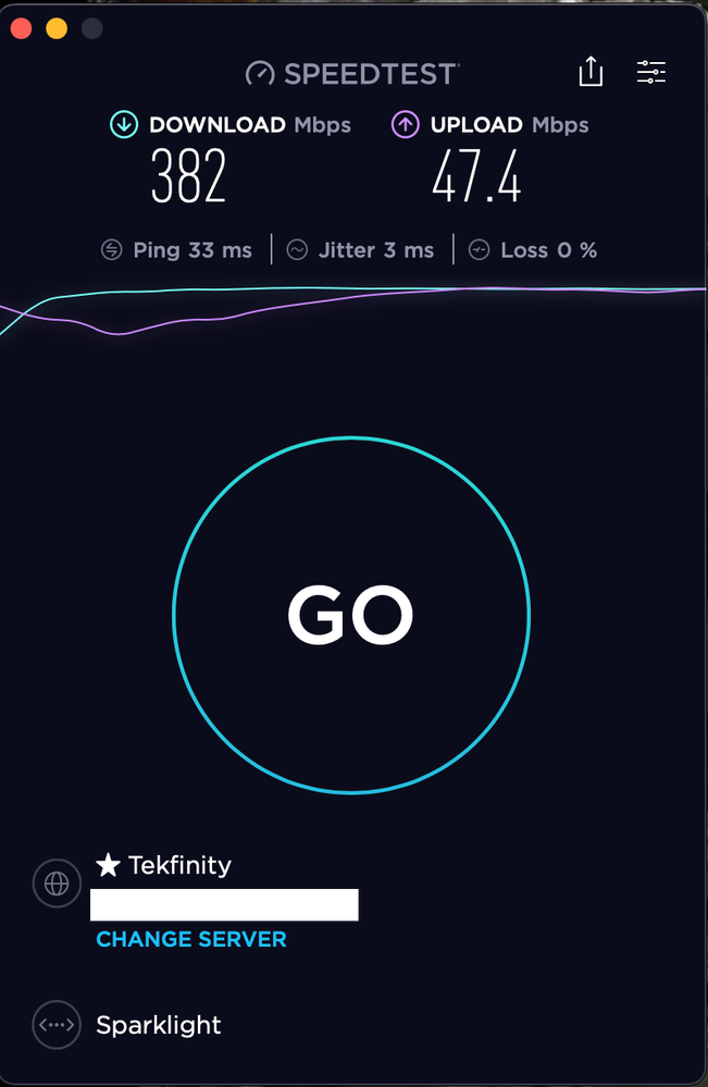

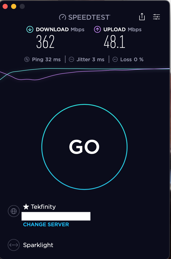

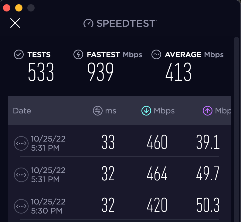

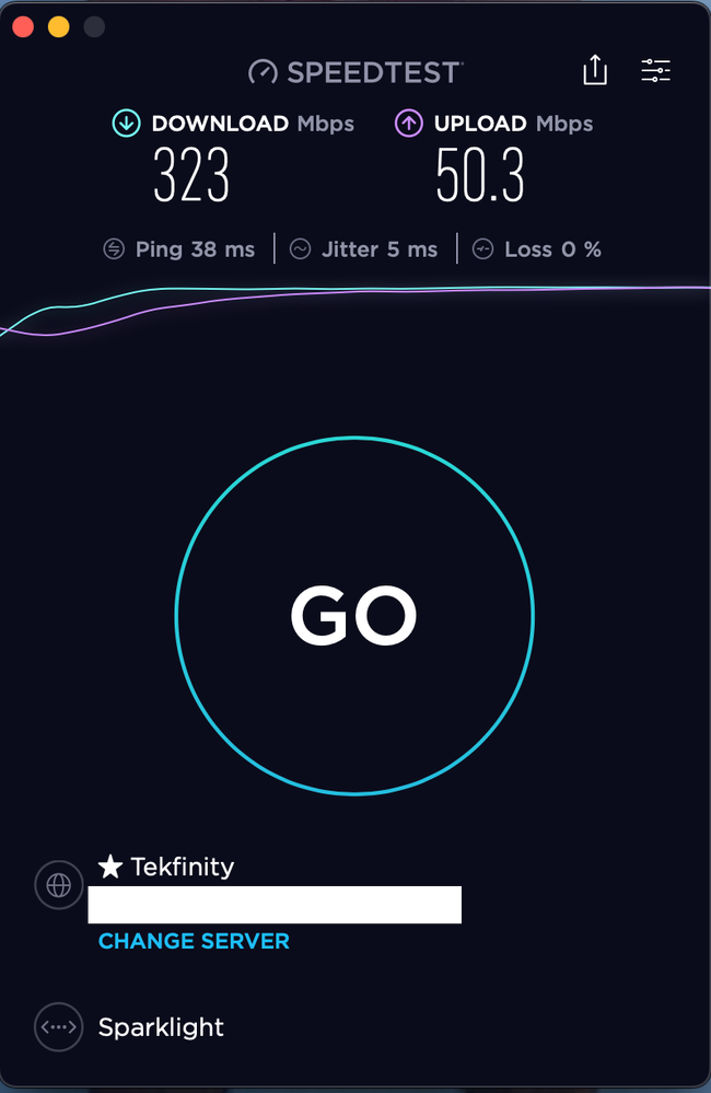

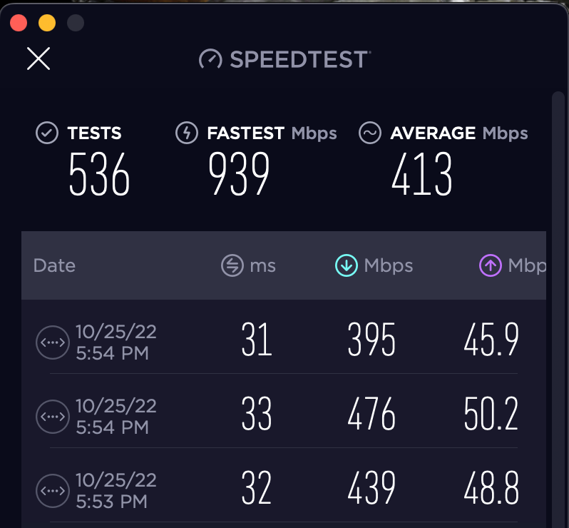

Posting to update that speed IS NOT capped on the CBK40 system using current FW builds of this date.
These results are with a Mac Book Pro ethernet connected behind a RBS20 v2.7.3.22 that is wirelessly connected to the CBR40 running v2.3.5.12. The system was factory reset and setup from scratch. NO saved backup configurations applied:
Saw no limiting or capping while connected at the RBS20. RBS and CBR40 ran well. I even connected my xbox to the RBS and gamed a couple of night. Saw no issues here.

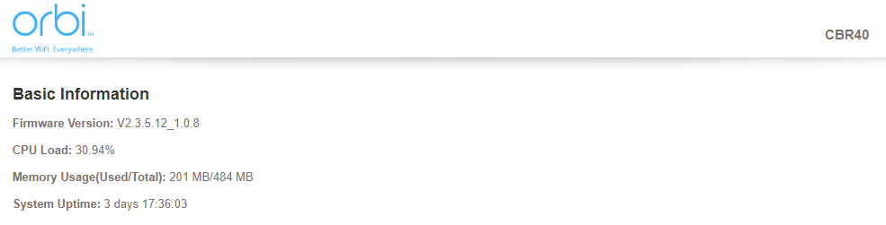

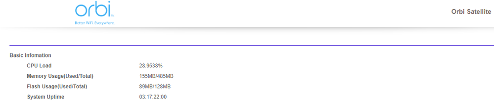

Those screen are taken from the RBS web page and the RBS debug page. All RBS and orbi systems have this info.
My system is circa 2017.
- GWildOct 31, 2022Guide
Your pages are different than my pages ...
- FURRYe38Nov 01, 2022Guru - Experienced User

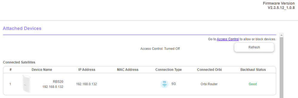

The first picture is taken from the CBRs Connected Clients page. The 2nd picture is from the RBS web page. The 3rd picture is from the CBRs debug page. All of these are standard across Orbi systems.

CBR IPAddress/debug.htm
