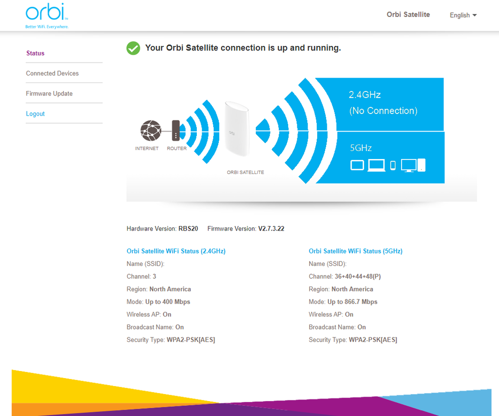

As you can see, my CBK42 is showing only one 2.4 channel, not 2 like your is, and that was after a full factory reset.
Also -- how did you get to an RBS20 screen that shows CPU loading. I have no such display on mine. You must have a newer hardware version.

Your pages are different than my pages ...

Sorry - no Orbi debug page on my kit. Can you be very specific what the URL is you are showing?
And according to my RBS and CBR status screens -- I have only ONE 2.4GHz channel working. Odd that the CBR and RBS do not agree on the bandwidth: CBR says 300M, RBS says 400M. Great software consistency.

CBR IPAddress/debug.htm
