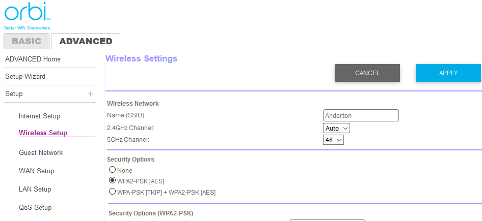

Very interesting - so I have no ability on that page or any others on my router to change anything related to power or transmission in any way. See my screenshot below. We must have different routers or firmware (per my profile, I have an RBR50 with the most current firmware. I wish I did have access to the transmission power settings...
- JoeCymruOct 21, 2018Virtuoso
Right now the image is not showing for me (image_unmoderated). What you should have would partiall look like attached
