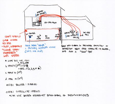

Greetings,
I believe this is likely a fairly common question here, but after searching for far too much time, I can't seem to come to the best conclusion for my case. I am looking for the absol...

Firmware version: 2.2.1.210 (which is the most current version AFAIK)
Modem: Cisco DPQ3212
Distance between router and satellite: ~50 feet (but as mentioned, the satellite speed seems higher than router)
2.4 Ghz Channels: Auto
Neighbors: Currently showing my guest network, and one other network. Occasionally will show 1 or 2 more, I believe. The one other network is currently showing it's Channel 4. From a cursory internet, and not extreme in depth understanding of 2.4Ghz characteristics, it seems Channel 1 should be a good channel for me to set to?
Security: WPA2-PSK
I'm currently unfamiliar with Beamforming and MIMO, so will need to research that further. Any additional insight is helpful for me and of course any future readers with a similar problem.

So I tried each recommended 2.4 GHz channel mentioned (1,6,11) and none made a significant difference in signal strength/speed.
I did note that my mini is connecting consistently to the 2.4 rather than the 5 GHz. Any other suggestions to strengthen the 5 GHz signal to the area?
