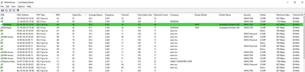

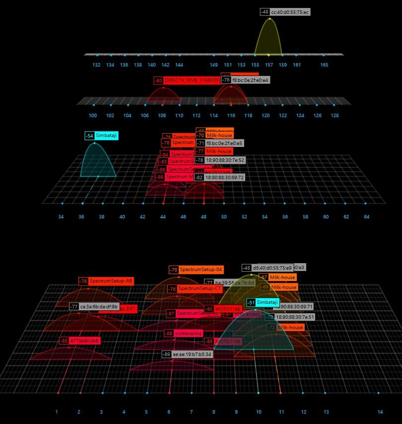

Wifi Commander shows my network producing 4 named radio frequencies and 1 mac address frequency.
Oh, darn. Appears that WiFi Commander requires a Microsoft Account to download. I have been satisfied with WiFi Info View from Nirsoft (totally free) https://www.nirsoft.net/utils/wifi_information_view.html . Is WiFi Commander worth the hassle?
Just to clarify, with four active WiFi access points, you should see:
- 4 Access points broadcasting the primary WiFi SSID on 2.4G (in your case channel 10)
- 4 Access points broadcasting the primary WiFi SSID on 5G
- If the guest WiFi is enabled, there should also be a total of 8 access points broadcasting the guest SSID.
With those signal levels, the WiFi transmission should be fine, with 2.4G devices never reaching a link rate above 400Mbps and 5G devices reaching a maximum link rate of 866 bps.

I use iPhone/iPad to connect to fast.com. I've attached an image of the wifi commander showing the 8 SSID and one mac address. My network is simbataji.

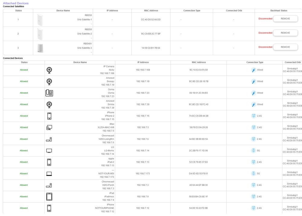

I turned off all of the satellites. Below is an image of the RBR50 Wifi signal and the currently attached devices.
One thing I noted as I turned off each satellite. Satellite 2 (RBS50) persisted after being turned off and was displaying the MAC address for the router (RBR50). After rebooting the MAC address was restored.
With this configuration my Wifi speed is averaging 40Mbps between an iPhone (NOTYOURIPHONE) and an iPad (iPadimus) - XL25AJan 22, 2023Tutor

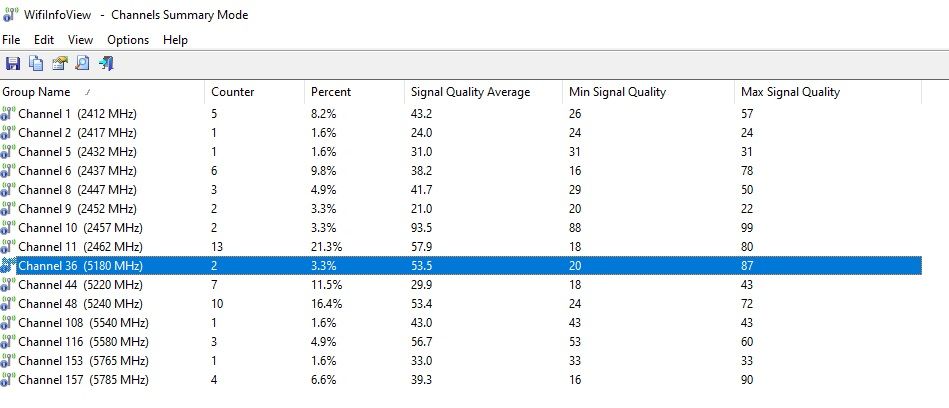

Could you do me a favor and install WiFi Info View on the Windows laptop?
On the "Options" menu, there is a choice of Channel Summary Mode. My 5G channel 48, for example, shows as 18.2%.
Thanks
- XL25AJan 15, 2023Tutor
Here are 2 images. Not sure how to fully glean information from this.
Also, current speed with just the RBR50 Wifi on iPhone/iPad is 6Mbps MAX while my PC is around 60Mbps and the iMac 70Mbps
