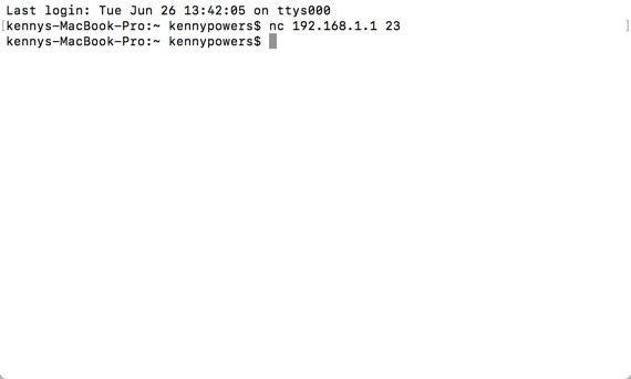

fineboi wrote:
When I try this on my MAC nothing happens except another line awaiting a command.
Make sure you enable telnet on the Orbi router first.
Change the above to the address of your router.

- st_shawAug 23, 2018Master
OzzzieMike wrote:
Thanks for simplifing how to accomplish this. I'm needing to do the same thing to connect my smart applicance (Whirlpool microwave), as it only works on the 2.4GHz band, and my phone must be on this same band during setup.
I'm not clear, though, on Steps 4 and 5 in your table. Are you on a Mac? (I am, and am wondering if that's what MA means in step 4?) And in step 5, is that what we enter in Terminal?
Yes, MAC means Macintosh.
On the command line in terminal you enter: nc orbilogin.com 23
This is the "netcat" command using tcp port 23 to connect to orbilogin.com. Apple removed telnet so you cannot use that. Telnet uses tcp port 23.

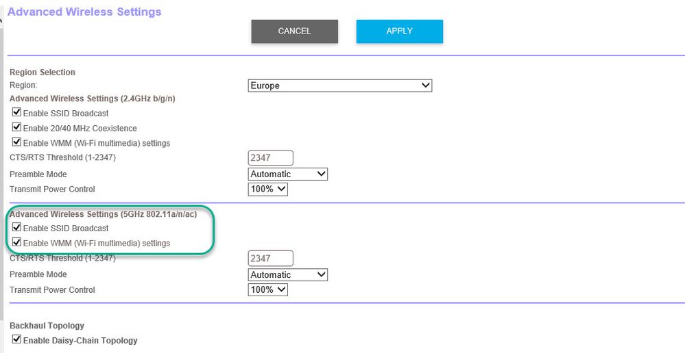

- Ozmeister2019May 20, 2019Tutor
Hi all, thanks for the information shared here. I know this is a few months old but just thought I’d share my findings. I needed to connect my Nest Protect(s) as well as a weather station to my Orbi RBR50 (FW V2.3.1.60), for which for I needed my iPhone to be on the 2.4Ghz Wi-Fi channel.
I found the easiest way to achieve this is to "hide" rather than turn off the 5Ghz channel.(In the absence of anything to easily turn it off)
1)Power off the Satellite.
2)Go into the routers web browser GUI -> Advanced Wireless Settings and then untick Broadcast SSID and WMM for the 5Ghz channel and click Apply.
3)Then go to your iPhone and Wi-Fi settings and click "forget this network", it should then disconnect.(Not sure how to perform "forget this network" on other devices but I assume it's just as easy)
4)Reconnect to your Wi-Fi using the SSID that is now only being broadcast on the 2.4 channel and voila it will have connected to the 2.4Ghz channel.
Afterwards just re tick the options shown in the above screen shot.
Hope someone will find this useful.
